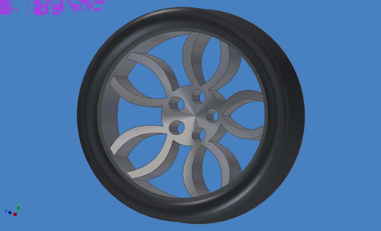

So for whatever reason whenever I bring any object from 3Ds Max or Maya into Keyshot 5 I get extremely weird results
Is there any reason why this is happening now?
I am using Max and Maya 2014

Are you using calculate normals on import ?
The images you are showing look as if the face normals are not unified. Are importing OBJ or FBX ?

I have tried calculating both on and off and each outcome is the same. So what I have tried
I started in 3ds max,  collapsed all modifiers on every mesh, reset the xform, then add another edit poly modifier to unify any changed normals then collapsed again.
After that I run an STL Check modifier to make sure my verts are welded and any other issues that might be there. I got a few errors that said I had open holes but they are in areas that will be under the ground so it's not an issues and never was in keyshot. Anyway I export the scene to a obj with maya presets.
That has been my usual set up before going into keyshot And has always worked until the update to 5.099
So when that issue I mentioned came up I went back into max and re-exported as an FBX while doing all that I wrote earlier in this reply. Same result.
So I went to am earlier version of the file and instead of collapsing I just exported it flat out as an obj. Same thing happened. So I tried FBX. Same thing. So then I tried the Max to keyshot plug in, that made it even worse. So then I tried a .3ds file. That failed as well.
So after that I copied the file, went to my older machine and saved it out on max 2012 and exported it out as an obj and FBX. Brought it into keyshot 5, still failed.
So then I figured maybe I need to reinstall my software but before I go through that mess I decided to test the obj that was failing in maya 2014, it came in fine with no issues. I tried the same obj on my wife's machine and loaded it in maya 2015 with no issues and then in XSI 2015 with no issues and then in MODO 701 with no issues.
So then I tried saving the file under the new packages and then exporting out of every 3d package my wife and I have and sadly I still got the same results even after using each programs normal pipeline, transform freezer, history eraser and so on and so on and after about 6 hours of back and forth it all failed.
I did however find a couple threads that have this exact issue in the keyshot forums and it seems to probably be an issue with the current version where it gets wonky if you have an AMD processor which I do have. The answers those artists received was that there is a fix in 5.1 but no one is sure when that will be released. So hopefully that fix is the answer to my problem because when I got keyshot 5.01 I had no issues at all and it was only after moving to 5.099 where the trouble started.

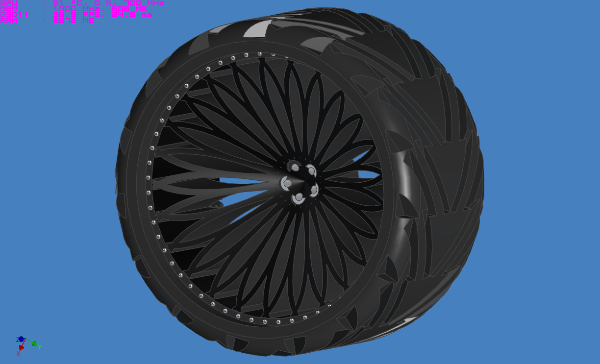

#8
Same issue here...
Using SolidWorks 2013, with Keyshot 5.099 + Kshot plugin. No exporting. SolidWorks quality set to max.
On the second image, can see the same piece rendered under Keyshot 4.3.
