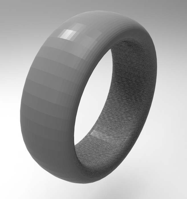

The seconde problem is that when I export a curved object (pic) I see many facets (export in .obj) while with an other render soft (Kerkythea) a friend tried and he don't have this problem.

Why don't you use native SketchUp import? The reason for the faceting is due to poor tessellation in the obj file.

All curved surface came from sketchup looks like the above.
Any idea?

Looks like working well if if I increase the segment number of the arch.
Now I try rounded corner and gives the result as you see on the screen capture. Is there anything I can do with it?
thomasteger
Apply the wireframe material and take a look at the tessellation of your model. Chances are that you have way too fe polygons.
