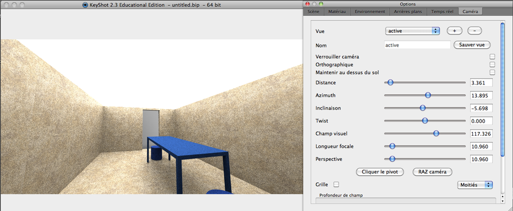

hello,
is it possible for renderings of indoor scenes, adjust the perspective without too much distortion?
in my example, it seems that the table is 10km in length ....
thanks
Antoine
w.wolf
#1
Use the Azimuth slider to line up the camera with the table then move the Perspective slider to the right to decrease the distortion and then you might need to adjust the Distance slider to put the camera above the chair ... I hope that helps, tell me how that goes ...
