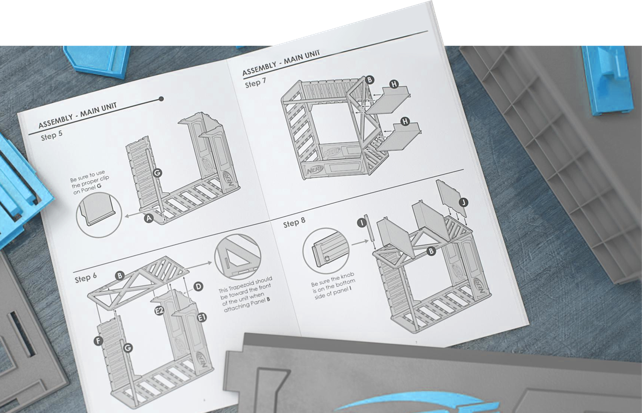

Hello,
i must do some  technical documentation, how to use Keyshot for this ? and how to achieve this particular look ?
thanks,
Zeltronic
Toon Material should be your friend on this kind of task ;)
jhiker
Looks like it might be a job for the 'Toon' shader.
Stefj
Ok, toon shader seems doing his job, but i have some problems with some lines...
Really not easy to have all lines...
For this kind of render, it seems that the camera must be in "Orthographic view" + "Isometric".
