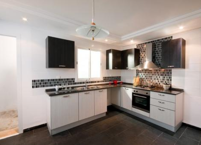

I also use HDR Light Studios Pro, as well as panels.  Here's our kitchen designs, now remodeled.  We went with the "dark" look, not painted cabinets.  Also, there was a recent post by a new member, with wonderful shots of his exhibit and stage designs, but I can't find his post.  Very inspiring.

Yes, the HDR does need to be able to access the subject.  On my kitchen remodel (my wife's hammering at me now to do the cabinets!) I started with an accuract, but not highly detailed, SolidWorks model.  Took about a day to measure and model, including the new appliances.
The important thing is that I did the ceiling in two parts so I could apply materials to suit.  I found that various combinations of glass worked well, allowing me to adjust the overall look and color temperature by swaping out materials.  Frosted worked great, and also if it was slightly warm tinted.  Anyway, the following images may give food for thought.  Great way to visualize a remodel!  Trick- take some real photos of the space, use them as backplates, hide the model walls, for example and use the backplate to adjust the view and perspective.
Bill G
