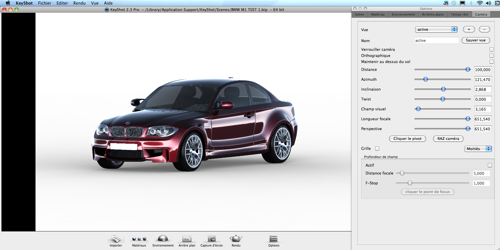

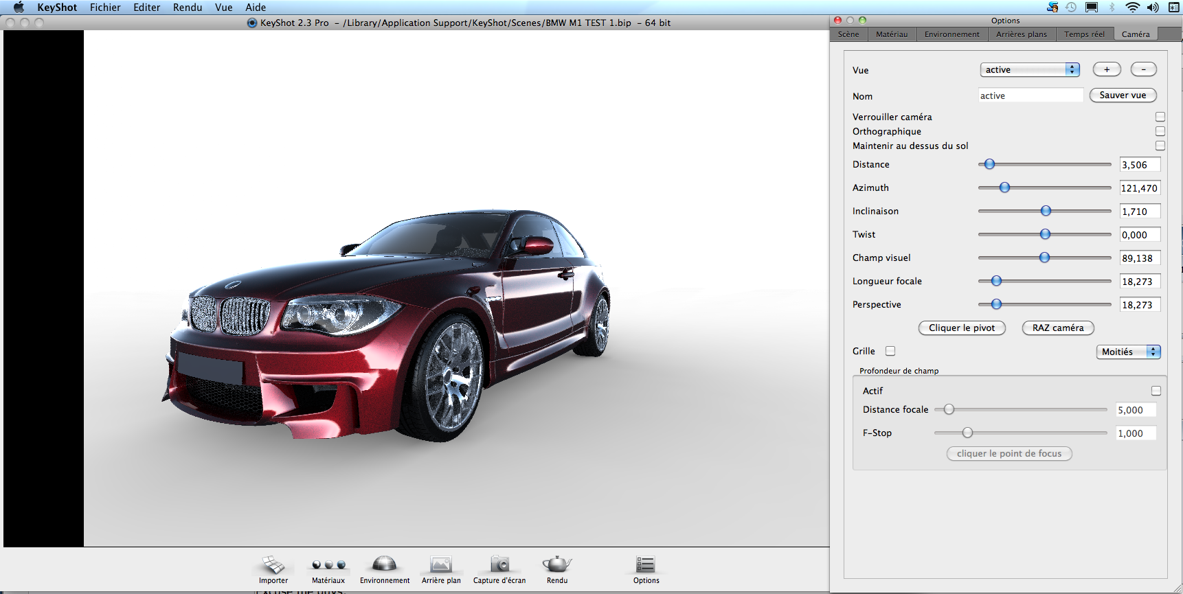

elliasp
  • Guest
Re: Camera two point perspective ?
« Reply #19 on: August 09, 2011, 03:53:53 pm »
Excuse me guys,
but as a professionnal photographer, it's called "lense aberation".
Indeed, when we have to resolve this problem, we play with focal lenght (in camera settings)....
For Keyshot it's the same : if you want to resolve this problem, you have to play with focal lenght : see exemples below, you will understand what I mean...

Offline Robb63
« Reply #21 on: August 12, 2011, 08:01:27 am »
I noticed you are using 35 as the focal length of the lens, try increasing this to 150-200 (or higher) that should fix the convergence issue. Just like a real SLR camera using a longer lens
