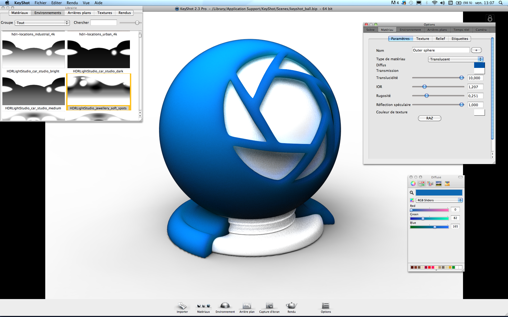

Unfortunatly my Keyshot is calculating, so I can't see the result I send you...
Hope it helps ;-)
