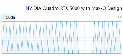

Hi everyone, I'm posting a new thread because I'm having some issues with my laptop and its RTX 5000 while using Keyshot (latest educational version, 10.2).
I don't know why while render the Cuda usage doesn't stay stable on 100% but constatly alternates between 100% and 0% like this:
Also, what's not clear to me is the following:
- I'm having some issues while changing the environment. For some reason the GPU mode is disabled and the scene automatically switches to CPU mode.
- CPU mode seems to be faster in the viewport (smoother scrolling and panning) for no apparent reason.
- GPU mose is only like 1.5 faster than CPU mode while rendering.
I intentionally bought a laptop with a 16 GB dedicated GPU because most of my scenes are very complex... but for some reason I'm starting to feel that my "old" RTX 2060 6 GB was performing better overall.
Any idea?

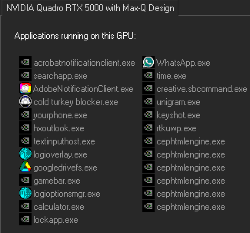

Also this is the list of programs using GPU on my PC right now (atm Keyshot is also rendering a scene) and for some reason Keyshot is not highlighted:
