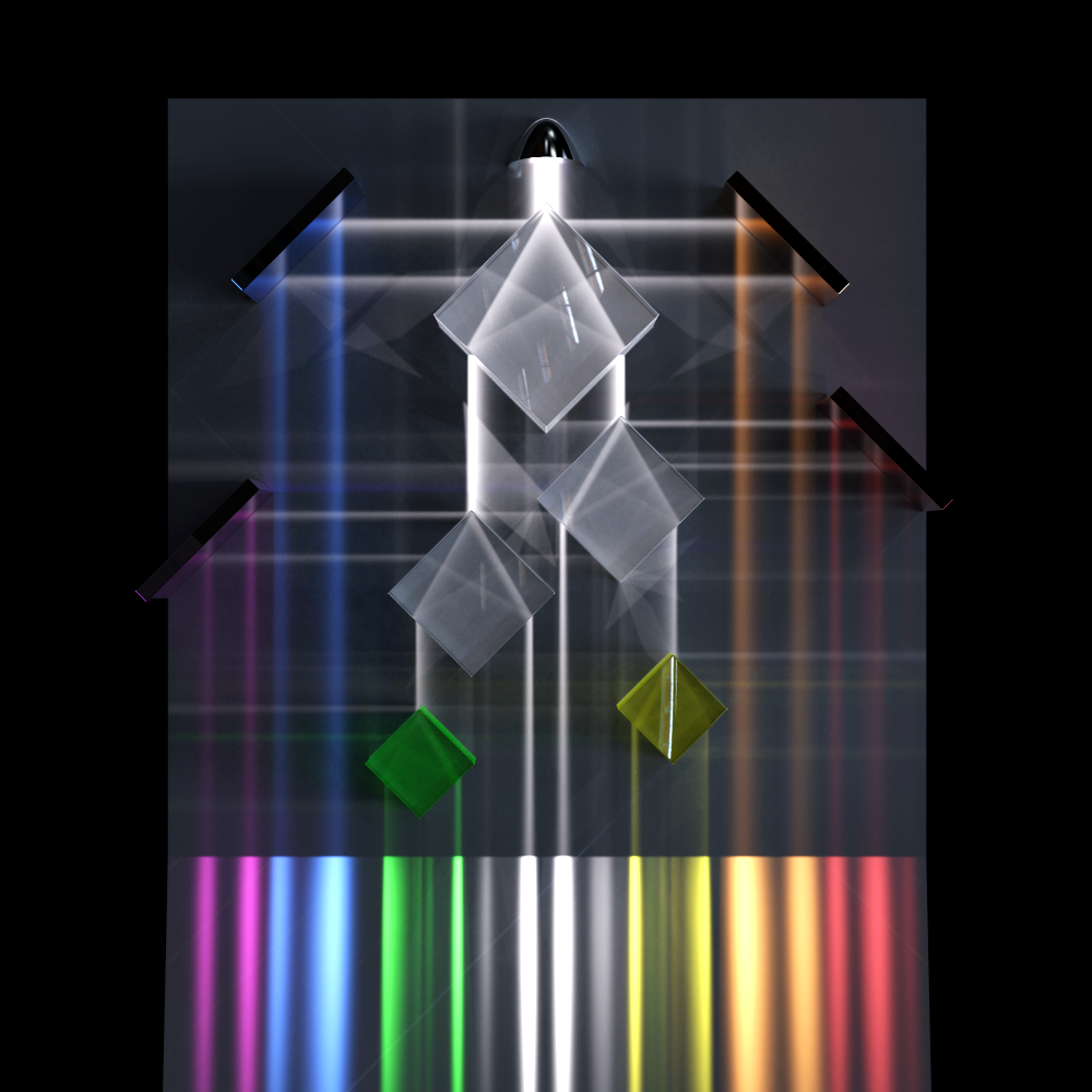

DriesV
#50
I just did these.
No dispersion this time. I used colored mirrors/prisms to create the colored light patterns. I put the 'catch' plane at a very low angle. That way, each light beam's intensity is distributed more evenly across the catch plane. This eliminated the very bright hot spots I was getting with the beams hitting the plane perpendicularly.

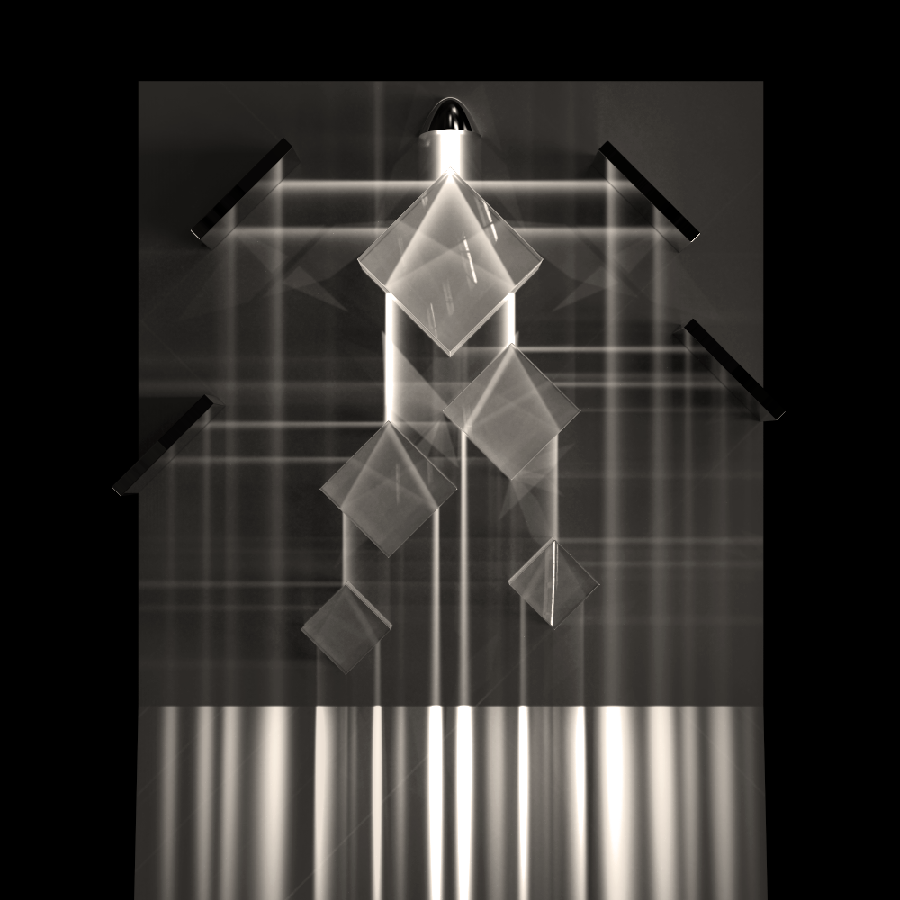

The second image has gotten a vintage treatment.
This is a single-shot KeyShot render. :)
No compositing, no postwork, except for some minor curve and color adjustments in Photoshop.
Dries

DriesV
Hmm, you got me thinking, Bill.
A rotation animation on the primary large prism would indeed look really good. I'm curious myself to see how the light pattern on the 'catch' plane would evolve.
These scenes do render quite quickly for what they are (32 ray bounces, many caustics due to many reflections/refractions). The caustics' quality improves gradually (sharper, less noise) as you let it sit (which is a huge benefit!), but it still takes +1 hour render times on a 32 core machine to get really sharp caustics at 1000x1000 px. Of course less complex scenes render much faster.
So if anyone's out there with a 256 core network rendering set-up with some idle time, I'll happily share my scene for an animation render job. ;D
Dries
